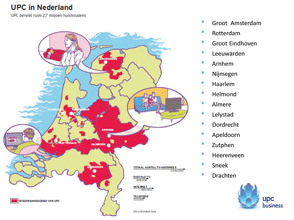

I should also mention that you are able to switch between router/bridge mode yourself if you are in a former UPC area (fUPC), otherwise a Ziggo moderator/helpdesk employee can arrange it for you.
IndianaStyle
No clue what that means!
Use the map below to determine whether you are in an fUPC area (marked in red):
IndianaStyle
I am in the red zone. How can I do it myself then?I cannot find it in the settings of the router.

that means ziggo must do the switch at their end
you can wait here for a ziggo moderator(employee) or call/chat with the main ziggo helpdesk
