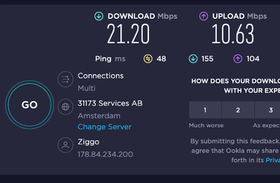

Thank you for answer and sorry for slow response. I have a very unstable internet today so I can get some data from it. My laptop is pretty close to router.
first image: speedtest test ping 48 instead of 5-10(at least 5 times longer), speed is 21.20 instead of 250mb(10 times slower)

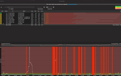

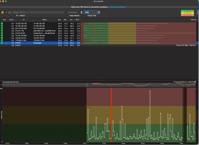

and  PingPlotter  screenshot

akosarev

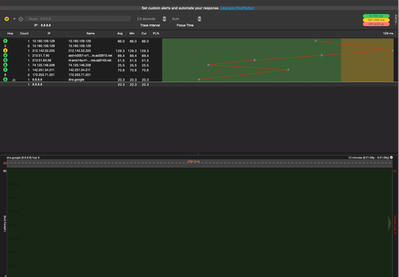

one more pingplotter screenshot
akosarev
and one more
