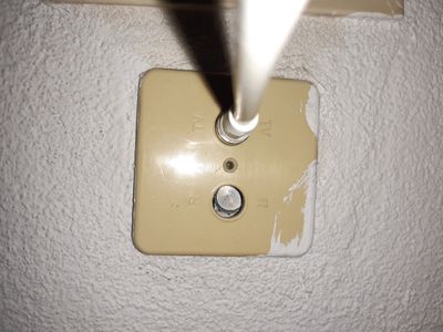

I'm also sending a photo of the Coax cable connection.
Any ideas if this can be an issue on my side?

Downstream shows significant noise (RS errors) due to 5G ingress, log shows that these channels are dropping out frequently. Upstream shows noise as well (deviated frequencies).
Is the modem connected directly to the AOP (main socket) or do you use a splitter/amplifier for connecting a TV/decoder as well?

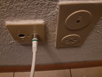

Looks like the main socket might have been upgraded internally (noticed the missing radio outlet). Could you unscrew its cover and post a picture?
Thanks! The modem is connected directly to the wall socket, nothing in-between. I can't unscrew the cover because it seems to be glued to the wall, and as the house is rented I don't want to do anything irreversible yet, but maybe this picture will help? The "R" hole appears to have no connection inside.
No worries. I have checked the visible part of the socket against current/common single-outlet sockets but have not been able to find any matches.

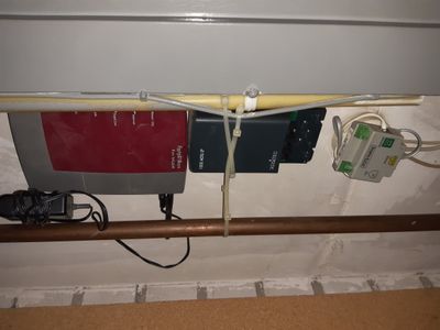

Just to be sure: have you checked the utility closet ('meterkast') for a coaxial socket and/or green cable?
The utility closet has an old ADSL modem, not plugged to the electricity; but no coaxial socket nor green cable.
Thanks, I expected as much, but it's good to be 100% certain. Installing the main coax socket inside the utility closet wasn't common until ~1990. The house appears older than that, judging by the looks of the PTT ISRA socket. Our house, built in 1981, has the exact the same ISRA socket installed into the wall.
