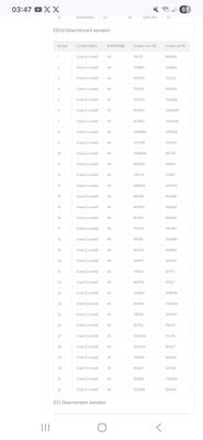

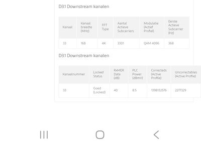

@tobiastheebe
kan jij misschien zien waarom mijn modem is herstart
3.0 Downstream channels
Channel Frequency (Hz) Power (dBmV) SNR (dB) Modulation Channel ID
1 730000000 6.1 40 QAM 256 17
2 602000000 6.8 40 QAM 256 1
3 610000000 6.4 40 QAM 256 2
4 618000000 5.9 40 QAM 256 3
5 626000000 5.9 40 QAM 256 4
6 634000000 5.8 40 QAM 256 5
7 642000000 5.7 40 QAM 256 6
8 650000000 6.1 40 QAM 256 7
9 658000000 6.6 40 QAM 256 8
10 666000000 7 40 QAM 256 9
11 674000000 7.1 40 QAM 256 10
12 682000000 7.4 40 QAM 256 11
13 690000000 7.6 41 QAM 256 12
14 698000000 7.4 40 QAM 256 13
15 706000000 6.7 40 QAM 256 14
16 714000000 6.4 40 QAM 256 15
17 722000000 6.1 40 QAM 256 16
18 738000000 5.8 40 QAM 256 18
19 746000000 5.6 40 QAM 256 19
20 754000000 5.6 40 QAM 256 20
21 762000000 5.6 40 QAM 256 21
22 770000000 5.3 40 QAM 256 22
23 778000000 5 40 QAM 256 23
24 786000000 5 40 QAM 256 24
25 794000000 5 40 QAM 256 25
26 802000000 4.5 40 QAM 256 26
27 810000000 5 40 QAM 256 27
28 818000000 4.8 40 QAM 256 28
29 826000000 4.5 39 QAM 256 29
30 834000000 4.4 39 QAM 256 30
31 842000000 4.1 39 QAM 256 31
32 850000000 3.7 39 QAM 256 32
Channel Locked Status RxMER (dB) Pre RS Errors Post RS Errors
1 Locked 40 244 3521
2 Locked 40 169 285
3 Locked 40 189 257
4 Locked 40 209 191
5 Locked 40 199 149
6 Locked 40 207 284
7 Locked 40 211 277
8 Locked 40 195 81
9 Locked 40 167 258
10 Locked 40 190 304
11 Locked 40 203 160
12 Locked 40 211 249
13 Locked 41 157 220
14 Locked 40 179 128
15 Locked 40 209 155
16 Locked 40 207 63
17 Locked 40 193 111
18 Locked 40 162 47
19 Locked 40 203 178
20 Locked 40 199 138
21 Locked 40 202 97
22 Locked 40 220 95
23 Locked 40 224 44
24 Locked 40 237 209
25 Locked 40 230 47
26 Locked 40 270 109
27 Locked 40 216 99
28 Locked 40 231 163
29 Locked 39 222 46
30 Locked 39 252 63
31 Locked 39 267 84
32 Locked 39 260 116
3.1 Downstream channels
Channel Channel Width (MHz) FFT Type Number of Active Subcarriers Modulation (Active Profile) First Active Subcarrier (Hz)
33 119 4K 2333 QAM 4096 858
Channel ID Locked Status RxMER Data (dB) PLC Power (dBmV) Correcteds (Active Profile) Uncorrectables (Active Profile)
33 Locked 38 0.8 3273261672 7
3.0 Upstream channels
Channel Frequency (Hz) Power (dBmV) Symbol Rate (ksps) Modulation Channel ID
0 58800000 43.5 5120 QAM 64 7
1 52000000 43.5 5120 QAM 64 8
2 45200000 43.5 5120 QAM 64 9
3 38400000 44.3 5120 QAM 64 10
Channel Channel Type T1 Timeouts T2 Timeouts T3 Timeouts T4 Timeouts
0 ATDMA 0 0 1 0
1 ATDMA 0 0 1 0
2 ATDMA 0 0 1 0
3 ATDMA 0 0 0 0
3.1 Upstream channels
Channel Channel Width (MHz) Power (dBmV) FFT Type Modulation
25 15.2 37.2 2K QAM 64
Channel Channel Type Number of Active Subcarriers First Active Subcarrier (Hz) T3 Timeouts T4 Timeouts
25 OFDMA 304 82000000 4 0

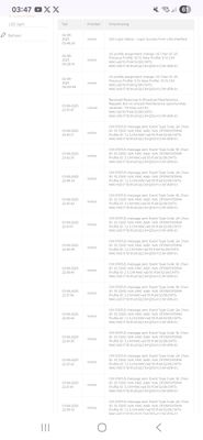

er is vziw geen onderhoud geweest
Network Log
Time Priority Description
13-06-2023 22:46:17 error DHCP RENEW WARNING - Field invalid in response v4 option;CM-MAC=cc:00:f1:d1:e9:cb;CMTS-MAC=00:17:10:91:a5:02;CM-QOS=1.1;CM-VER=3.1;
13-06-2023 01:31:06 critical Started Unicast Maintenance Ranging - No Response received - T3 time-out;CM-MAC=cc:00:f1:d1:e9:cb;CMTS-MAC=00:17:10:91:a5:02;CM-QOS=1.1;CM-VER=3.1;
13-06-2023 01:21:12 critical No Ranging Response received - T3 time-out;CM-MAC=cc:00:f1:d1:e9:cb;CMTS-MAC=00:17:10:91:a5:02;CM-QOS=1.1;CM-VER=3.1;
13-06-2023 01:09:46 warning DBC-REQ Mismatch Between Calculated Value for P1.6hi Compared to CCAP Provided Value;CM-MAC=cc:00:f1:d1:e9:cb;CMTS-MAC=00:17:10:91:a5:02;CM-QOS=1.1;CM-VER=3.1;
13-06-2023 01:09:06 critical No Ranging Response received - T3 time-out;CM-MAC=cc:00:f1:d1:e9:cb;CMTS-MAC=00:17:10:91:a5:02;CM-QOS=1.1;CM-VER=3.1;
11-06-2023 19:08:49 notice REGISTRATION COMPLETE - Waiting for Operational status
11-06-2023 19:08:47 warning REG-RSP-MP Mismatch Between Calculated Value for P1.6hi Compared to CCAP Provided Value;CM-MAC=cc:00:f1:d1:e9:cb;CMTS-MAC=00:17:10:91:a5:02;CM-QOS=1.1;CM-VER=3.1;
11-06-2023 19:08:42 notice DS profile assignment change. DS Chan ID: 32; Previous Profile: ; New Profile: 1 2 3.;CM-MAC=cc:00:f1:d1:e9:cb;CMTS-MAC=00:17:10:91:a5:02;CM-QOS=1.1;CM-VER=3.1;
11-06-2023 19:08:40 notice TLV-11 - unrecognized OID;CM-MAC=cc:00:f1:d1:e9:cb;CMTS-MAC=00:17:10:91:a5:02;CM-QOS=1.1;CM-VER=3.1;
11-06-2023 19:08:19 warning DHCP WARNING - Non-critical field invalid in response ;CM-MAC=cc:00:f1:d1:e9:cb;CMTS-MAC=00:17:10:91:a5:02;CM-QOS=1.1;CM-VER=3.1;
11-06-2023 19:08:17 notice Honoring MDD; IP provisioning mode = IPv4
11-06-2023 19:08:15 critical No Ranging Response received - T3 time-out;CM-MAC=cc:00:f1:d1:e9:cb;CMTS-MAC=00:17:10:91:a5:02;CM-QOS=1.1;CM-VER=3.1;
11-06-2023 19:08:06 warning ToD request sent - No Response received;CM-MAC=cc:00:f1:d1:e9:cb;CMTS-MAC=00:17:10:91:a5:02;CM-QOS=1.1;CM-VER=3.1;
11-06-2023 19:07:58 critical Received Response to Broadcast Maintenance Request, But no Unicast Maintenance opportunities received - T4 time out;CM-MAC=cc:00:f1:d1:e9:cb;CMTS-MAC=00:17:10:91:a5:02;CM-QOS=1.1;CM-VER=3.1;
10-06-2023 20:19:04 warning RNG-RSP CCAP Commanded Power in Excess of 6 dB Below the Value Corresponding to the Top of the DRW;CM-MAC=cc:00:f1:d1:e9:cb;CMTS-MAC=00:17:10:91:a5:02;CM-QOS=1.1;CM-VER=3.1;
10-06-2023 04:29:57 error DHCP RENEW WARNING - Field invalid in response v4 option;CM-MAC=cc:00:f1:d1:e9:cb;CMTS-MAC=00:17:10:91:a5:02;CM-QOS=1.1;CM-VER=3.1;
